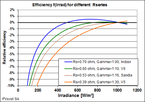

The Rserie has a high impact on the Low-light relative efficiency. So that we may use this measurement for fixing it accurately.

There is a linear correlation between the Rserie and the Diode Ideality factor (Gamma). .
With the PVsyst, version 5: the default was based on the diode ideality factor, fixed at 1.30 for mono, and 1.35 for poly crystalline modules, according to our outdoor long-term measurements. However this lead to very bad low-light performance, and the PVsyst simulation was known for underestimating the PV yield.
With the version 6, up to V6.25 : on the basis of Sandia Laboratories outdoor measurements of about 100 PV modules, we updated the fixed diode ideality factor, at 1.05 for mono, and 1.10 for poly crystalline modules, improving the low-light performance.
Since version 6.26 (July 2014), for crystalline modules, we observed from many measurements of independent laboratories that the low-light relative efficiency at 200 W/m2 is rather stable, around -3% with respect to STC. This is now the default for modules without an explicit definition of the Rserie  (and eventually Rshunt) parameters. In this way the low-light performances of the PV modules - as proposed by default - are close to the reality.
