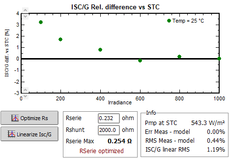

This graph shows the ISC / G ratio, from these measurements.
We can observe that the values are rather well aligned, except for 100 W/m2 which shows an over-performance of almost 4%. This has a big impact on the low-light adjustment, by pulling the low-light efficiencies up.
We may evaluate the Irradiance measurement errors by supposing that the ISC is quite proportional to the irradiance. The button "Linearize ISC/G" will adjust the GRef of each measured point, in order to get a perfectly linear ISC/G ratio. In this example, this will define a GRef of around 104 W/m² for the first point.
