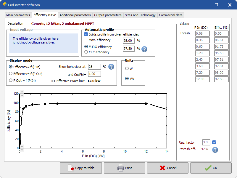

This transfer is usually given in terms of efficiency as function either of the input or of the output power. That is, it is represented by a non-linear curve, with a threshold input power which may be understood as the inverter's own consumption.

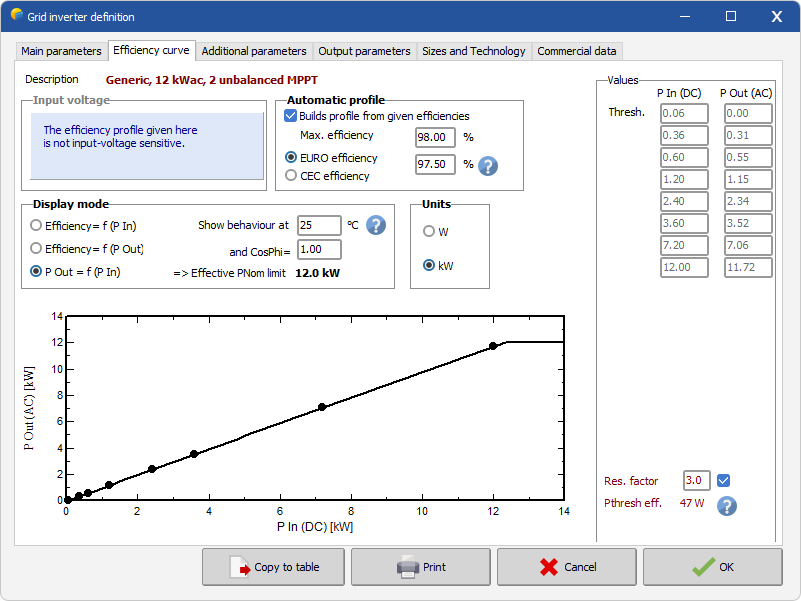

However, it may be more convenient to transform this curve into an input/output power characteristic: the behavior then becomes practically linear, with a pseudo-straight line cutting the abscissa at the working power threshold. The efficiency elbow at low powers is for a great part due to the mathematical transformation of this threshold. Inverter manufacturers try to improve the efficiency at low powers, giving rise to a hardly visible improvement on the beginning of the straight line (when represented as Input/Output graph).
The ohmic effect of the output circuits (transistors and transfo) induces a loss which increases quadratically with the current (or power), leading to a decrease of efficiency after a maximum.

- Up to the power threshold (often named "Starting operating at ..." in datasheets), the input power corresponds to internal consumption for the internal needs of the device, and doesn't produce power.
- From this threshold, the device is supposed to produce an AC power proportionally to (Pin - PThresh). This production is penalized by an ohmic loss of the internal components (transformer and transistors), which increases quadratically with power (like R · I²). When translated into efficiency, this gives a maximum efficiency usually around 50-60% of the nominal power.

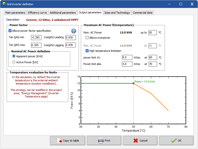

- POut limitation starts when the inverter nominal power is reached. This limit may depend on the temperature and on the power factor, as explained in the "Grid inverters - Output parameters section". The user has the possibility to challenge (T°C, PF) combinations to see what is the limit and to understand what the simulation will do in practice.
- Beyond the limit, the Efficiency=f(P In) mode shows a decrease of efficiency. This can be explained in the following way: whatever the input power, the output power remains the same and so, mathematically, the ratio POut/PIn drops.
A practical example is given below, for 12kVA generic inverter showing an overpower behaviour with an apparent power limitation. If such an inverter operates at 35°C, its Pout limitation will be 13.2 kVA, so 13.2 kWac with a power factor of 1. With a power factor of 0.9, the maximum active output power would drop to 11.88 kWwac. The limitation would start at (Pin, Pout,Efficiency) = (12.166 kW,11.880 kW, 97.66%).
This is more easy to understand with the POut=f(P In) mode :
