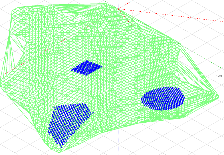

There are three distinct zones of fields placed on a hill, each zone has a unique nominal tilt/azimuth pair. All fields follow the terrain slope so their normal vectors are varying.
Shadings definition
Here is the scene after we imported it in PVsyst :
OrientUC3_Shadings1
We can clearly see the three zones

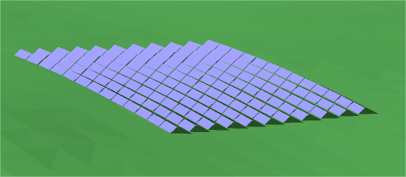

This shows how fields follow the ground slope.

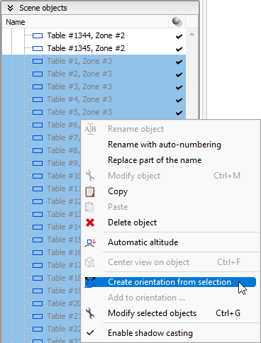

Let's start with the first zone, we select the fields using the lasso selection tool in the scene.
OrientUC3_Solution2
When the fields are selected, we right-click on one of them in the right-panel and select Create orientation from selection
OrientUC3_Solution3
Now the new orientation appears in the orientations tree. It contains the selected PV objects and the tilt/azimuth/base slope are the average calculations of those PV objects.
Now we repeat this operation for the two other batches.
