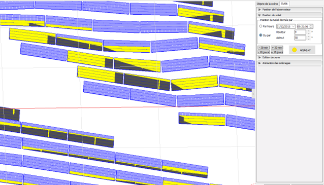

On each PV table in the 3D scene, one defines rectangles called partitions, each of these representing an area that may be impacted electrically by a single shade. When any of these partitions is sufficiently shaded, it is considered inactive (as far as the direct irradiance component is concerned). This electrically shaded partition is colored in yellow in the 3D scene animations.
The electrical loss on the beam component is calculated as the difference between the electrically shaded area, i.e. the yellow rectangular partitions, and the “linearly” shaded surfaces, shown in grey.
partitions_3D_example
Figure 1: partitions with any amount of shading will be shown in yellow in the 3D scene animations.

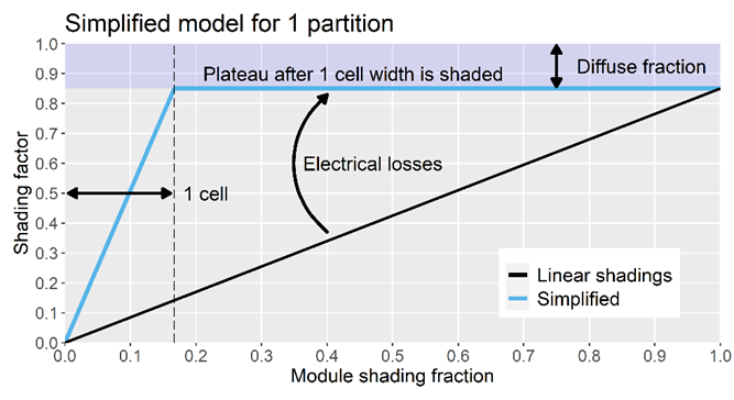

Based on the observations of the previous discussion, the partition model aims at implementing the behavior shown in Figure 3. Over a partition, assuming regular row-based mutual shadings, the electrical shadings increase linearly with increasing linear shadings, until a cell width has been shaded. At this value the total shading loss reaches a plateau value. The direct irradiance shining on this partition is considered lost.

Figure 3: partition model definition

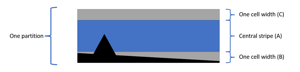

In practice, shadings are not necessarily regular. PVsyst therefore implements internally a decomposition of all partitions in 3 stripes shown in Figure 4:
  • a central stripe, which if shaded, will force the maximum shading losses value on the partition,
  • two one-cell-wide side stripes, on which the shading factor is considered proportional to the shaded area.
In regular situations this replicates the behavior of Figure 3.
partition_model_implementation
Figure 4: Model implementation with the central and side stripes. In the shading situation shown in black, the shading loss is maximum since the central stripe is shaded.
