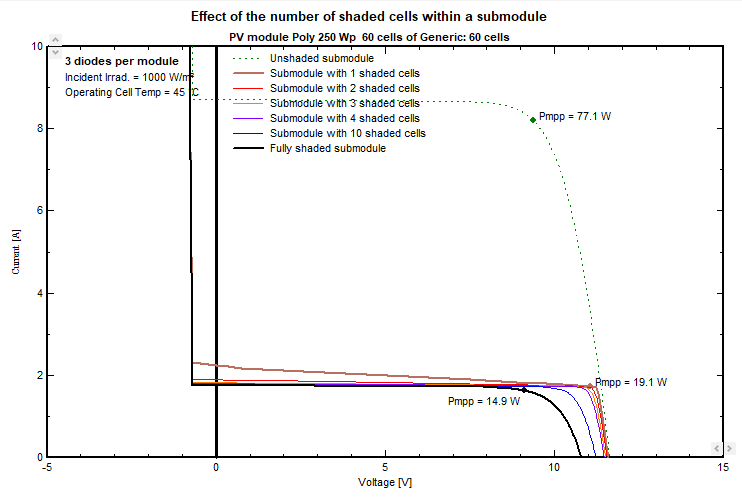

However the By-pass diodes have also an effect on the electrical shading losses. The submodules are indeed the basic unit when analyzing the electrical shading losses an an array. Whatever the number of shaded cells in a submodule, the resulting I/V curve of the full submodule is quasi-identical. Only the Pmpp voltage is slightly different, but in an array the shaded submodules or strings rarely operate at MPP.
Therefore, when analyzing/constructing the I/V curve of a shaded array, the "Module Layout" tool only deals with sub-modules characteristics (either shaded or unshaded). The individual cells may be completely forgotten.
This plot is available in PVsyst "Tools > Electrical behaviour of PV arrays > Array with shaded cells".
Here you can choose "Number of shaded cells effect > One sub module".
