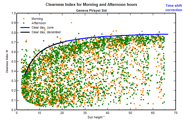

Hourly Kt morning/evening, which represents the hourly measurements of morning and evening Kt values in different colors.
- This is a very sensitive test for the real time shift of your data: a scrollbar allows to modify the time shift value, resulting in very dissymmetric distributions between morning and afternoon points. The best timeshift is when the morning and afternoon top points are well balanced.
- This also shows how the absolute values of Kt match the Kt corresponding to the Clear day model, as a function of the sun's heigth.

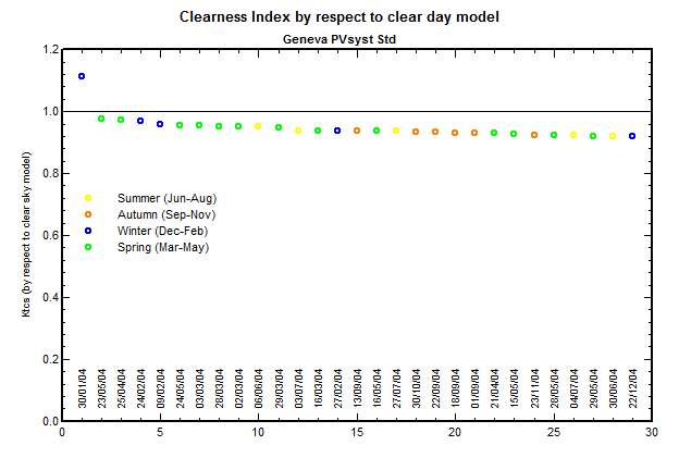

Monthly best clear days shows the detail of each monthly best day data with respect to the the clear day model, sometimes explaining why the value in the first plot is not well aligned.
Best clear days Ktcc displays the sorted Ktcc of all days of the year. The Ktcc is the clearness index referenced to the clear day model (not to the extraterrestrial). This graph gives an idea of the calibration of the irradiance sensor: the best days of the data should be close (within 5%) of the clear sky model, i.e. Ktcc=1.
