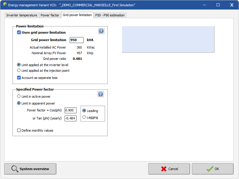

The grid limitation may be defined in the project's dialog, button "Energy Management".
Here you can decide whether you have a grid limitation, and specify its value.
The limitation may be defined:
- either at the inverter level: the inverter power is limited to the rated value, and the power injected into the grid is further reduced by the losses defined after the inverter (auxiliaries, AC wiring, transformer).
- or at the injection point level: the maximum power delivered to the grid is indeed the rated limit, the inverter will have to deliver a higher power for compensating the losses after the inverter.
This limitation may be required:
- either as active power (expressed in kW),
- or as apparent power [kVA]: in this case the effective active power [kW] is limited at a lower value than the apparent power limit [kVA]. The Cos(Phi), specific for the grid limitation, may be specified in yearly or monthly values.
The limitation itself will always be managed by the inverter as a clipping loss.
When checking "Account as separate loss", the results will show separately the loss due to the inverter limitation itself, and the loss (named EUnused) due to the additional condition of grid limitation. This does not correspond exactly to the physical behavior of the system, which will always clip at the inverter level, but it is meant to show explicitly the part of the clipping losses due to the injection limitation.
