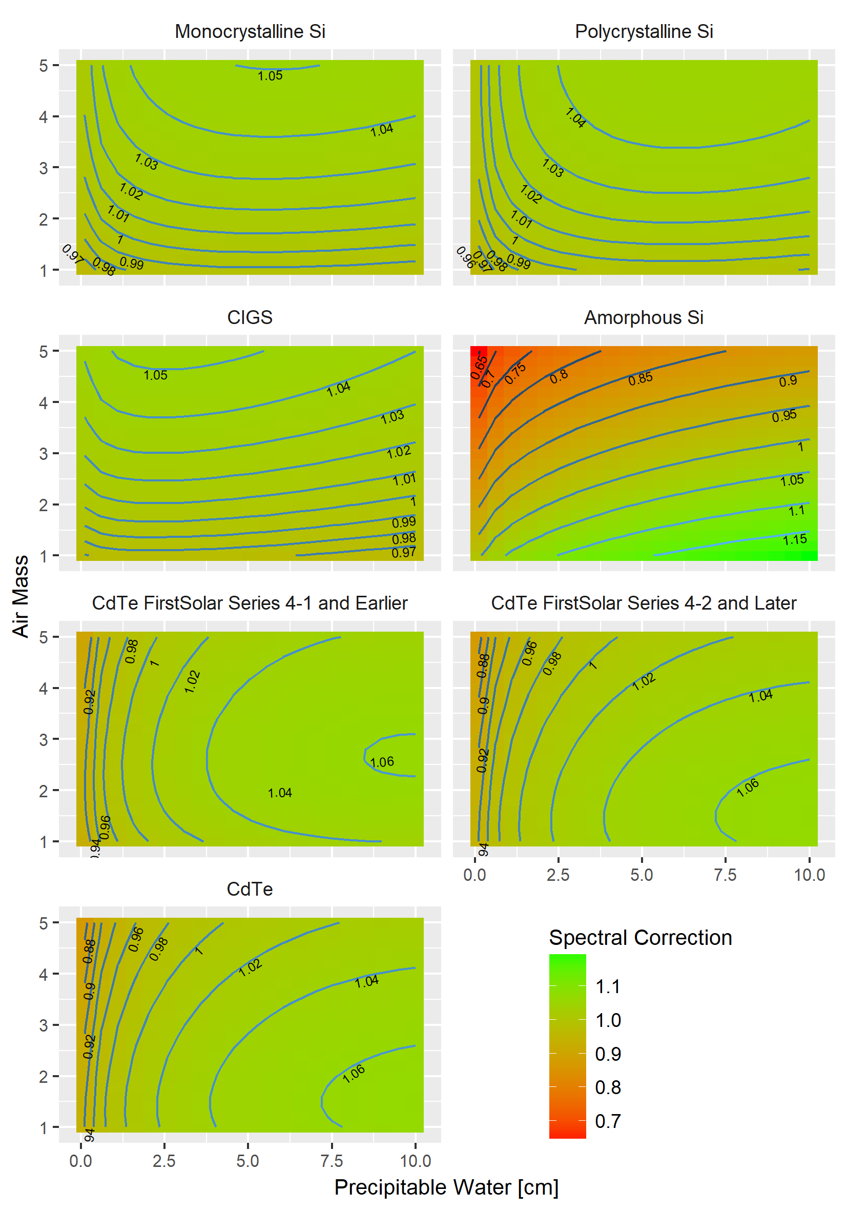

The plots below give an overview of the correction factors for the different set of coefficients for an air mass range from 1 to 5 and a precipitable water range from 0cm to 10 cm.
