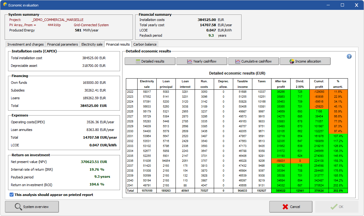

This section summarize the profitability of the system. The most important results for makers are the net present value, the payback period and the return on investment ratio.
It also details annual balances between costs defined in Installation and operating costs section and revenues according to the pricing strategy defined in Tariffs section.

PVsyst calculations
Using the effective production given by the simulation, PVsyst shows the annual balance as well as the accumulated balance over the foreseen lifetime of the PV system, according to all these strategies. It also shows details on an annual table.
But be careful: these balances result in differences of large quantities, and little perturbations either on the real production or the effective costs may result in dramatic deviations of the final profitability !
This is namely the case for the annual real irradiance variations, with respect to the meteo data used in the simulation. Failures of the system all over its lifetime may also significantly affect the effective balance.
