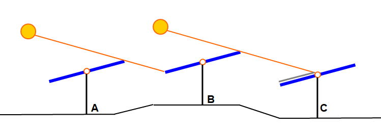

Backtracking_DiffAltitude
When the backtracking angle is calculated for the trackers A and B (at higher altitude), a shade on the tracker C (at lower altitude) is unavoidable. Here half the tracker is shaded.

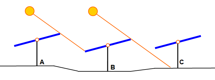

Backtracking_DiffAltitudeB
Inversely when the tracker B is lower than the tracker A, the tracker C has not an optimal tilt for collecting the whole available sun's light. A better tilt would intercept more light, this corresponds to a loss due to the cosine effect.
